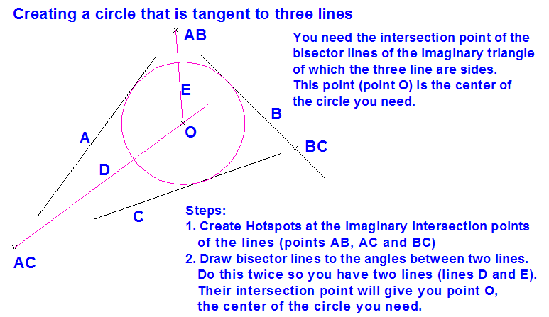

I think the circle tangent to three line solution was not yet posted.
Here it is.

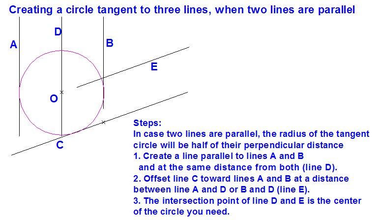

Here is another one that is a specialized case of the previous one.
