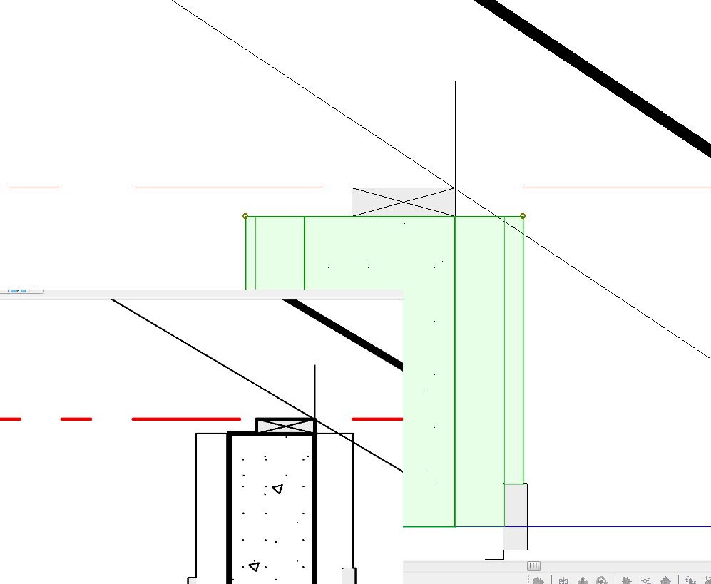

Can't see separator lines of composite walls in section.
I see the separator lines in plan view but not in section.
When I select the wall in section I can see where the lines should be.
Why don't all the separator lines show up?

Til wrote:
Steve,
as you are using the same fill for different skins, in section the rule is : same fill=merge.
If you want to separate them in section just duplicate the original fill and use alternatively for example empty_fill/empty_fill1/empty_fill/empty_fill1 etc
In plan view the rule is not the same all skins show and never merge except if you set them accordingly.
Some like this subtle difference, some don't
I bet that's it! I will give it a try. Thanks!
Steve Jepson
Yes. That was it.
