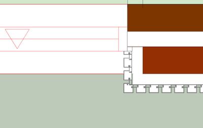

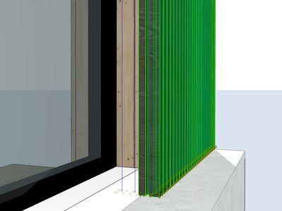

I have vertical aluminium batten cladding terminating against the window frame but the window opening cuts the cladding and exposes the wall behind.
This is modelled with a complex profile column.
Is there a way to model this so thatt he battens are visible inside the reveal?

Make sure that the building material of the cladding is higher then the building materials of the wall.

I would put the cladding on a seperate layer and set the Intersection Group to something unique.

So simple, thank you so mucj
