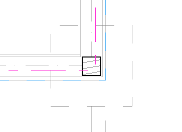

The fact that dashed lines do not cross at their endpoints is perplexing since Autocad has always done this. I am working with an Architect on a project who will not tollerate it. I don't like it either and might be forced to somehow had draft the lines.

Check the linetype settings. In the attached image, it appears that if the first dash setting is 0 the line starts with a dot. All other linetypes in that image have a positive integer as the first dash figure, and all start and end with solid sections.

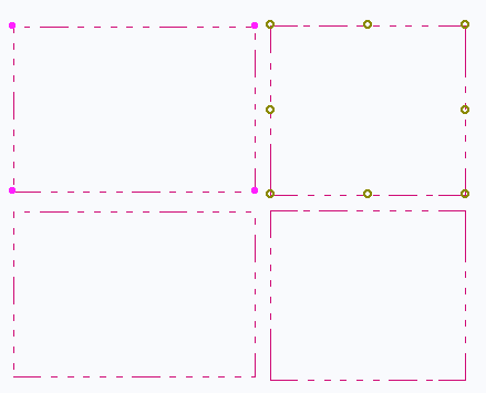

Using poly lines have this result.
If you use grouped lines then they close.

Thanks for the feedback, guys. I see that there are workarounds, however it does not help when showing a slab footing - unless there is yet another workaround.
