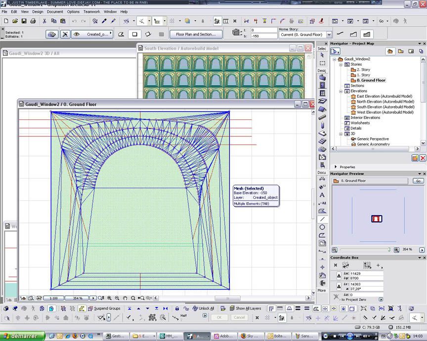

Interesting problem there Ignacio. I have to ask a few questions though.
Are you working with any technical drawings (CAD or otherwise) that contain the technical data specifically of the curvatures and elevations of the Windows?
Because if that is the case then I really don't see why you wouldn't be able to do it in ArchiCAD using a combination of the mesh tool, SEO, and profile manager.
And the second thing is; 15 hours????? IMHO there must have been something you were doing wrong or overly complicated.
Normally I would hash out something curvlinear and freeform/organic like this in Rhino (since it's faster and more logical for me than Maxonform)and then import it into AC using either Maxonform, Zoom GDL or the 3ds import plugin ( assuming it's not too heavy polygon-wise. But if I were forced to make it completely in ArchiCAD using the basic tools, I would hammer out that bad boy using the aforementioned tools like so.
(bearing in mind that I'm modelling this completely fromthe single image you provided and trying to complete it as quickly as possible; hence the low resolution curves/surfaces and some of the inaccuracies that may be apparent)

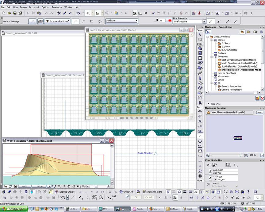

Starting with the mesh tool and using 2 Elevation (or Section) views, 4 primary contour curves.......
(click on images for larger views)
......and then using the elevations as mentioned, to check the curvature and combined with profile manager for additional profiles as shown with the fill in the elevation window in the lower left below. The other elevation window is the completed compilation.
As usual click on the iamge for a larger view.....
.....after a few more tweaks of the mesh and some SEO subtractions here and there, the final object is saved as a window as shown in the final window object tool below. And then just select it and place in the wall as required......
........final compilation of created windows in wall shown in the 3D perspective window. As I mentioned earlier, I did it hurriedly and with few contour curves hence the low resolution mesh

Bricklyne wrote:
\And the second thing is; 15 hours?????
It was *1.5* hours for some of the basic geometry, and realising that there was no way I was going to want to figure out and ArchiCAD-draft the projections of the paraboloids and tori and whatever in order to produce true contour lines.
(The construction drawings include overall dimensions, only some radiuses in a single vertical section and a bunch of curves with radii annotated 'to be approved by the architect'. The architect wasn't aware that those are not circumference arcs.)
It took me about 5 h to come up with some sort of believable mesh based on 6 contour lines which works on distant views and fails on exterior closeups because I can't have some of the mesh contours as hard edges and some as soft, and because it is hard to produce smooth curves (that is, avoid discontinuous variations in slope) fudging a bunch of contour lines. When I first open a 3D window it takes like 5 minutes to generate the first exterior view already (it goes fast after that), so I'll skip solid element operations on this one. I don't have the picture to attach now, which is good because one should never look at ugly things.
When I am back in the mood I'll fudge in some profile for the hard edge and when I need them I'll fudge the 2D views. This is the first time in like 7 years that I need true 'freeform' modeling.
