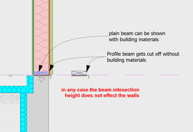

  A solution might be to buid a small (bottom plate) profile with a beam and place
it at the correct height -  (This could include flashing, sill plate gasket etc. )
  I dont think there is a reaction between the beam- wall  heights
like there is with the wall-wall heights.

Taking from @Karl Ottenstein & @RandyCthoughrs,
You can create foundation and sill plate as one complex profiled beam.
It shouldn't intersect with the brick wall or the Cladding.
AC 29 INT 4006/WIN 11
RandyC
  Unfortunately  in real life the flashing or other components are lower than the bottom plate
I have tried it adding to the foundation wall but the more complicated the profile the slower the computer gets.
this is why a simpler beam profile might work better.   If we could assign building materials to profiles then
we could show the hidden items by increasing the strength of the profile.
