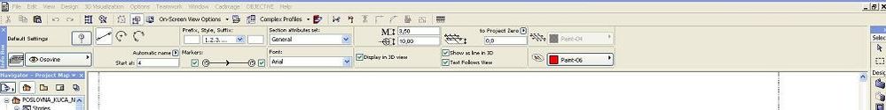

if u want to see grid tool like u want folow these steps !
go to WORK ENVIROMENTS - TOOL SETINGS DIALOG BOXES - GRID ELEMENT TOOL !!!!
SELECT WHAT U WANT TO SEE !
PIC1
PIC 2

There is a ArchiCADWiki article with further information if you need it - http://www.archicadwiki.com/TechNotes/Grid%20Tool%20Panel%20Visibility
Bruce
That's fantastic! Why didn't I think of that?
The bizarre thing is, it was working fine before Christmas, then I come back after the break (same work environment) and it had changed.
Oh well, fixed now - and another thing learnt about ArchiCAD.
Cheers

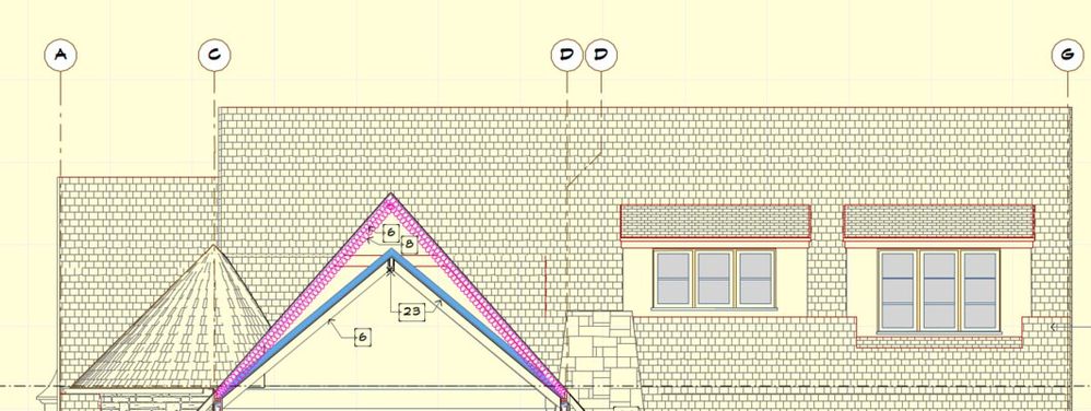

The insufferable rogue grid lines are back wreaking havoc in sections and elevations with the auto-staggering trick. Now it's only one grid line in the file, but I can't shake it. Delete and draw a new one, copy and paste a good one, drag a copy of a good one, close the file and start over--nothing works. And instead of just a random stagger, it's a stagger AND a correct non-stagger at the same time.

Dave - it's not the grid settings that do this, but rather the Section settings.

Yes, the bug is related to the Section setting to Auto-stagger, but it is a bug. I should not be getting a two-headed grid marker, one staggered and one not, at the same time. And in the project that was the subject of the screen shot, there wasn't any conflict that required a stagger any way.
