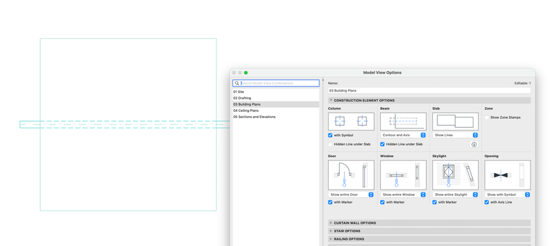

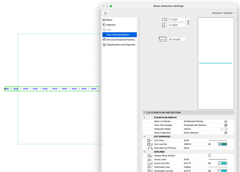

ok i believe to have looked everywhere @ every sub user interface and sub-user check box, color, cut/fill line, pen, every setting available and within every setting combination and layer unfortunately i can't seem to get my floor beams to show as hidden below my floor. the highlighted beams are shown in the attached.

Model view options, display order, beam settings all need to be juggled together. Here are the settings to get it to work on my end:
Patrick M
Ace
if you want them to show without a dash, you need to make sure the MVO is NOT set to 'hidden line under slab', then bring the beam forward by display order, or make the slab cover fill transparent or off
