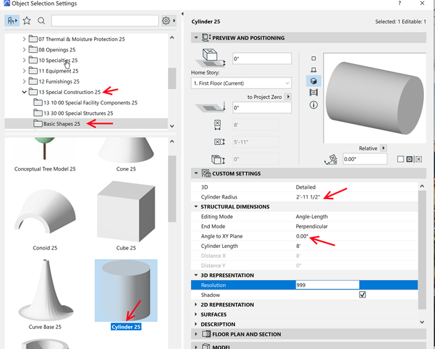

In any case, you can make a hole at any angle in a mesh using SEO and the Cylinder object from the Basic Shapes folder in the library.

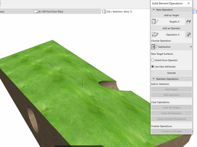

I've tried that, but after the subtraction, the mesh stays solid, there is no hole.

Did you put the operator in a separate layer so you can turn that layer off?
