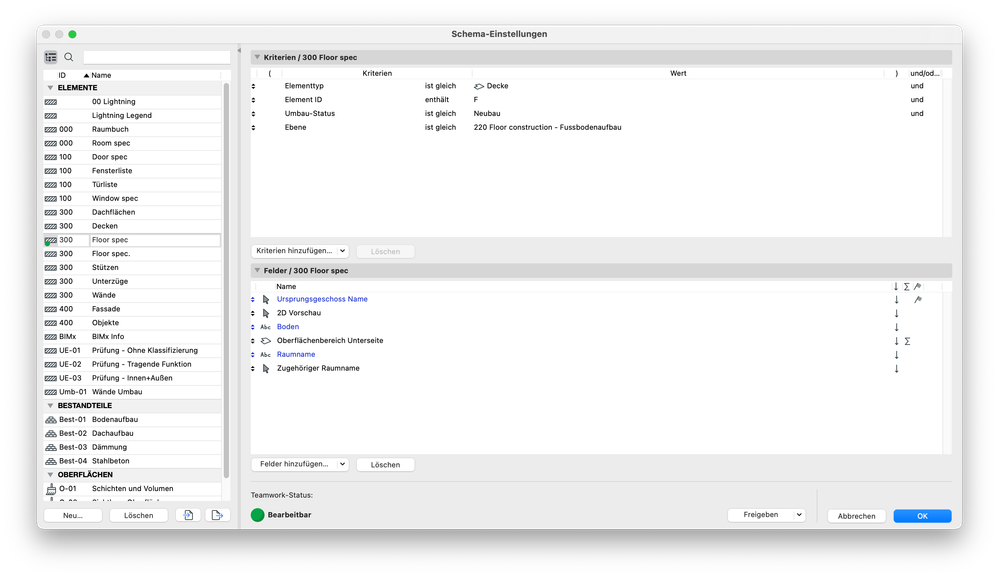

Hi there,
I am generating a floor finish schedule and I would Archicad to show me the belonging zone defined by the zone stamp where the element is positioned.
For example: if I have a wooden floor in the master bedroom, where I have already set up the zone stamp, I would like to see it in the schedule, automatically, in the field "zugehöriger raumname" - associated room name.
At the moment only one element works, I have tried to replicate that element, but it doesn't work everywhere which means that I have to manually type the "associate room name".
I would like to ask: what is the logic that automatically connects a slab element to a zone stamp, and what are the parameters/setting I have to control to display in the schedule the "associated room name".
It is always difficult to explain a technical issue, therefore, I hope I have provided enough information to understand the topic.
Please, let me know if I can provide more info.

How do you set your floor types? By modeling a floor structure above a structural slab or by defining the floor type in the zone tool settings (no modeling)?
Could you post a screenshot of the schedule settings? Which Zone Stamp library element are you using? In the GER library I have Raumstempel DIN / ON / SIA?

My floor types are defined by a slab element and by the zone tool, as well.
The zone stamp I am using is Raumstemple ON 25.

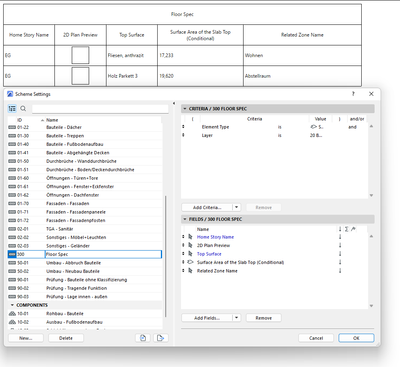

Your Schedule is an Element Schedule. The Related Zone Name (Zugehöriger Raumname) you are trying to read is the actual Zone Name parameter of any used Zone Stamp. The Related Zone Name is a General Listing Parameter and you can read more about it's relations here.
I have re-created your Schedule, but I couldn't resolve where you pull the "Boden" data from, so I replaced it with the Top Surface parameter. I get the Related Zone Name without any problems, but if you manipulate the Zone data there are some things you need to consider - you need to close the Schedule, update the changed zones, and then re-open the Schedule - this way the Schedule will rebuild from current Data. If you change the Zone Name parameter and just switch to the Schedule window the Schedule doesn't rebuild the changed Zone data.
As @Christophe Fortineau said, your Zone bottom surface has to border the top surface of the Floor Slab (I think it will also work if the floor slab element is within the Zone volume).
