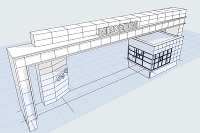

1. It's the top floor slab, why can't I see the ones below?
2. In 3D, it is united with the wall below, but it is not combined in plane. Why is this?

1, The walls and slabs are joined so that the wall lines are not visible.
2. I can see things that should be covered by the slab.
(The way I solved it is the fact that you have to turn on cover fill.)
2-1. The lower ones that raise the top slab to the Bring to Front are covered.
However, the grid lines did not appear even when I raised them with Bring to Font, so I lowered the slab with send backward just in case.
Only then did the lines appear. (In Autocad, it is possible to set these below, but if you lower it, it will continue to go down, but it is difficult to adjust it in Aki.)
3. The second slab seen from the top floor cannot be covered even if it is raised.
What should be covered refuses to go down.
In 3D, the right side is joined, but the left side is not.
4. This also does not work with the same phenomenon as above.
Of course, the second top plate is also covered filled.
5. This is a 3D document. I want it to be like this.
The grid is cut off here.
I didn't know that the easiest thing in a 3D view program would be so difficult. ^^
What I want to know is that the top view should be used is the floor plan and the top floor.
It is a fact that the option of the walls to be displayed must be set to All relevant stories.

Are you using storeys? This is the easiest way to setup horizontal views

1. The slab needs to add a layer to appear.
2. Slabs must use only the outermost lines. It didn't matter if it was a bond or not.
3. Come on! Now we need to adjust it to the display order.
You don't even know which one takes precedence.
The one below is just coming up.
Experienced people seem to be able to drag this object into a layer.
If you are a beginner, you must know nothing.
You just have to.
ah! this
I got everything set up, but the grid doesn't come up.
No matter what, the grid didn't come to the top.
I put the grid on top again.
But no matter what, the grid doesn't come out with a warning message.
I lied 100 times. There was no beep.
(I found out later, but the Grid was locked. ^^
When I loosened it and raised it as much as possible, it was blocked by the slab. I lowered the slab one step at a time to fit it.)
I gave up now and lowered the slabs. Walls rise below.
The walls underneath need to be lowered again.
I got it all right while swearing with my mouth. ^^

5. I found out about one.
The Grid was raised to the top after reset default order at the end. The problem seems to be that these things should come from experience, not from commands.
