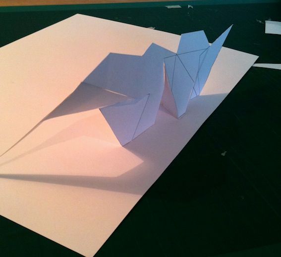

How would you go about creating this? (accurately)
I'm in the process of making a rough model of part of a building concept at University. I'm quite familiar with the tools in ArchiCAD but since this structure is not 'typical' the tools don't seem to accommodate, or at least not in the way I would like them to.
I've tried creating this elevation (image attached of model) with a mesh, since the outlines of the elevation were created in ArchiCAD (2D fill), however, I can't rotate the Mesh on the y axis i.e it's drawn on plan but in 3D it needs to be rotates 90 degrees so it becomes a wall.
I've also tried creating each piece of the wall using OBJECTiVE but again, this takes far too long and I'm still left with empty spaces on the wall. ( the Model shows that there are walls protruding inside and outside of other elements)
I guess the mesh could work but it's just that it doesn't look like it can be rotated in 3D.
Thank you for your help.
PS I know the concept may look 'crazy' ( well contemporary architecture) but that's what they want in Architecture school these days...

NStocks:
1. Using Mesh: you can save ArchiCAD elements as library parts, when saving them you choose which side is up so you can rotate the Mesh. For more information with images, go to Help > ArchiCAD Help, when your browser opens click on the "Search" tab, and input "Saving 3D Models as Objects" in the search box, in the results list "Saving 3D Models as Objects" will lead to detailed information.
2. Using Roofs: Each plane would be one roof, so you would need as many roofs as there are planes. You can select and stretch roof nodes in the 3D Window so they meet other to create your design.
Neither of these solutions will accept windows and doors, so creating openings will be another issue.

Windows and doors are fine, as long as I can create roofs/mesh that are translucent or that use glass materials. Again the school doesn't 'like' us to use a standard 2MX1.8M high door, or even a square door... The image I posted: the front part i.e closest to the camera is part of the 'front entrance'...
Thank You
