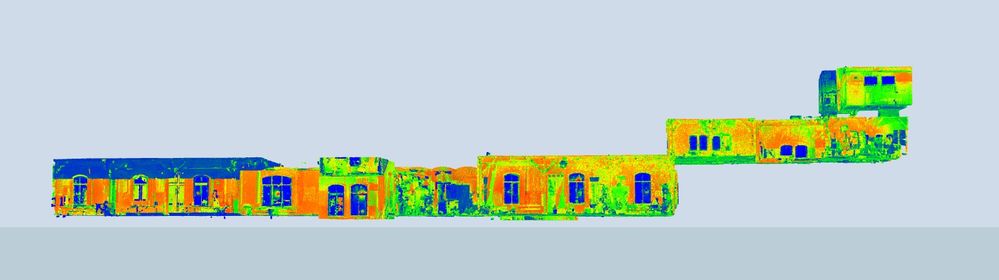

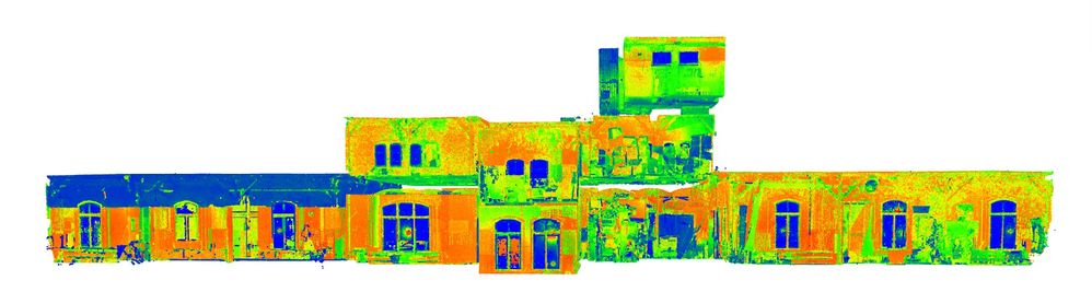

Hello,
For months I have been struggling with this specific problem:
When importing E57 point clouds a into new, empty model, everything works fine. But as I keep working on a model (add 2D and 3D elements, views, change different settings etc.) and try adding more point point clouds that should stay aligned (e.g. subsequent stories of a building), suddenly one or more stories get kicked a few meters away horizontally.
While importing, I always stick to non-rotated floor plan. The issue is not about rotation but moving, though.
While importing, I always choose to place point cloud's origin at model origin.
The attached model does have this issue. If you import the two attached point clouds together in it, you'll see they are misaligned. However, if you import them into an empty model, they will stay properly aligned.
I have found a workaround that utilizes hotlinks. I import point clouds to an empty model, save them as hotlink module, place the module in my old model and embed it (break links), so the point clouds become part of the old model, and then they stay aligned. However, this method takes extra time which I want to save.
I always try to avoid transforming (rotating, moving and scaling) imported point clouds in my models. I treat their original coordinates as holy, as I often need to add extra clouds afterwards, and they have to stay aligned. Not to mention how slow Archicad is, whenever you try manipulating a point cloud.
This is clearly an Archicad-related problem, because these two point clouds are properly aligned when imported in other sortware, like Cloud Compare or Revit.
I noticed one more strange thing that seems related to this issue and might be a clue to help tracking down its root.
A point cloud imported to a new, empty model, based on default Archicad template, has its virtual corners (bounding box marked with black dots) wide just enough to enclose the actual physical span of point cloud object.
When you import these clouds into my attached model, their bounding boxes extend hundreds of meters beyond the cloud's actual size, but only until you change any setting or coordinate of the point cloud object.
Below, screenshots how they should look (upper) and how they look (lower):
Links to point clouds (they're too heavy to attach them here) - same content in both links, at your preference:
