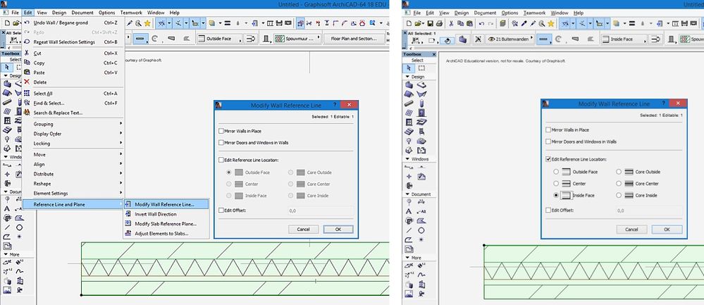

Go to Edit > Reference line and Plane > Modify wall reference line
Dontknow
With image:

Thank you for your detailed reply!
I found my problem. When I upgraded to 18, I carried forward my custom Command Layout Schemes and when I did that the new Modify Reference Wall Line command was not visible anywhere. In Work Environment I couldn't even find it under Edit to add to my Toolbars. I had to apply the AC 18 Standard Command Layout Scheme before it would even show up.
