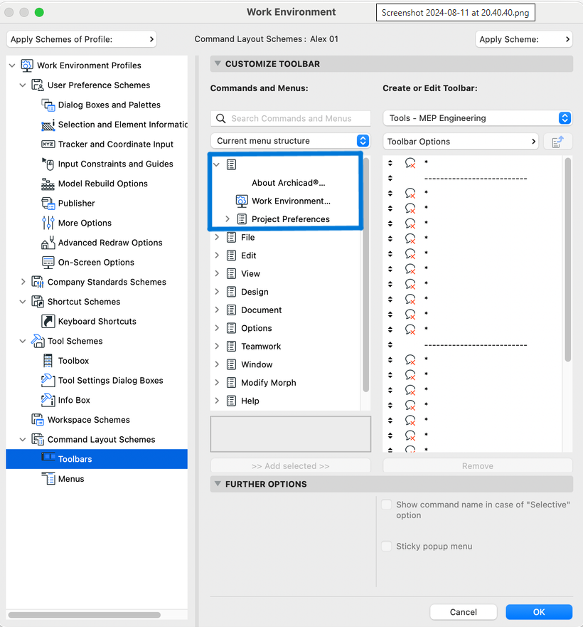

alexliz
Thanks, @Mahmoud Qenawi , I'm giving it a try as I type. I activated the MEP Engineering toolbar but it's full of 'empty' icons - no tools. Only if I activate the MEP Work Environment does the toolbar get populated with tools. Is this a bug?

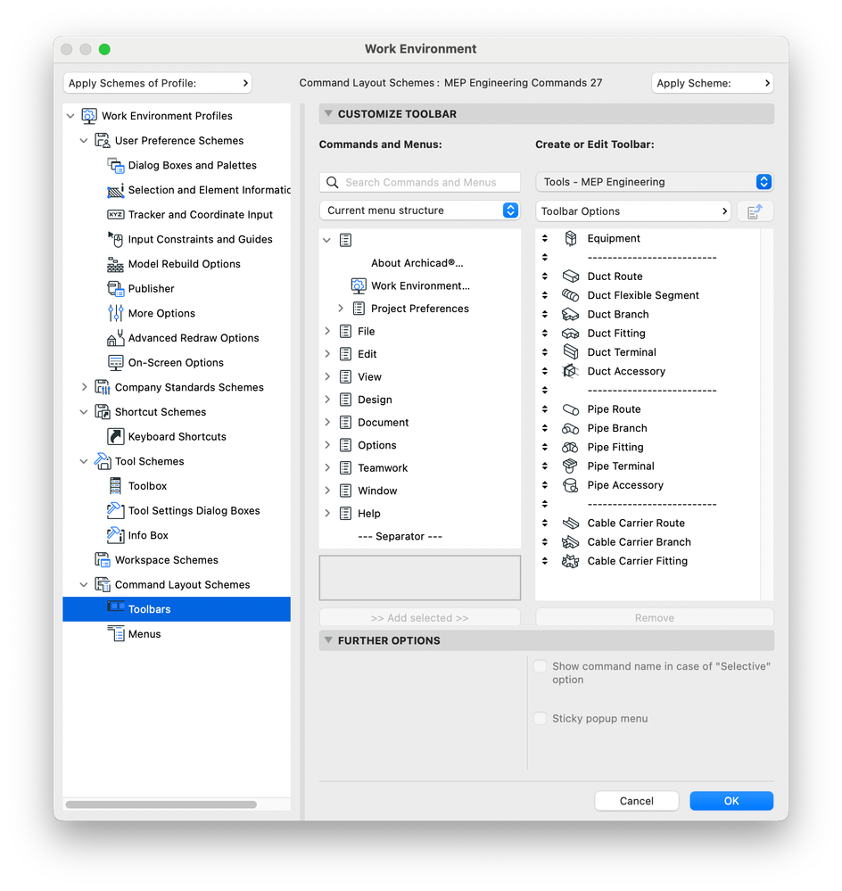

No, it is not a bug.
You need to have the MEP commands added to your Work Environment toolbars and menus.
Or as you have discovered activate a WE that has them already.

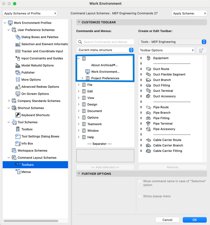

In addition to Barry's reply,
I see there's an area in your WE window which I couldn't understand, is it a default option in your WE or added by your custom (Alex 01) one?
* As the default WE window doesn't contain this area.
