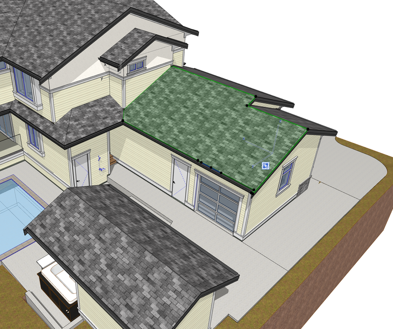

I am a couple months into my Archicad journey. It is tough to find help on one-off items. When drawing roofs I need to show roof rafters correct and I found Shoegnome's video #66 https://www.youtube.com/watch?v=4r1Ug2E22Wo on roof construction techniques helpful. I modeled a roof using it but since the roof is a double gable, part of the roof overlaps.
I've used multi-plane roof for both roofs that intersect. Following Shoegnome's video I have a composite roof, then a composite outline that is just the rafter tail, then a composite for the asphalt shingles over all of it.
Shoegnome is unavailable and suggested I go to the forum to ask the question.
Do I just subtract from from Polygon the overlap or is there a better way to do this.
I would love some feedback on whether video #66 is the best way to do this or is there a better way.

Hi @farmer ,
I believe I understand your issue. I think the easiest way to solve it is to convert the roofs to single plane roofs (see attached). You could then perfectly align the two roof edges to be seamless, or, better yet, combine the two roofs that are in plane so they read correctly in plan view as well. Multi plane roofs are handy for modeling but limited afterwards.

Hi Farmer,
If you watched Jared's video he shows you what he does to model a more accurate roof structure for a hand framed roof. I do this in a very similar way to Jared if I am modeling this type of roof.
If on the other hand you are just doing preliminary design and don't need the detail in section or elevation you can do what you have done so far but modify it as Nate indicated. As the 2 rear roof pieces are on the same plane you can just add the piece that you have over the smaller width section to the rear plane of the larger roof. Add a node at the lower ridge of the larger roof and then add the rectangle of the smaller rear section roof piece. You can then delete the smaller rear roof plane. Same on the Garage roof pieces that you show.
Cheers, Gerald

Thank you, I always need to show detail in sections. Even when I perfectly align roof sections I get a line in 3D view.  I have been using the 3D view for screen shots but maybe there is a better way to show the 3D view for quick updates? A quick 3D render or something like that?
I'm not sure you understood what I was trying to say or perhaps I'm misunderstanding you. I'm not quite sure what line you are talking about but if you make the 2 rear roof planes into one there won't be a line. See attached showing the combined roof plane highlighted in green.

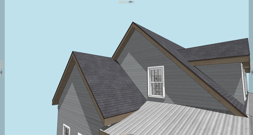

Gerald. Understood. When I use Shoegnome's solution without the last shingle layer that covers it all, my roof and the eves have a line between them. Attached is that with no shingles. It also happens when I add another plane to it as in the case of the other attached.

Farmer,
OK the 1st image is correct in how it will appear before you put your top shingle plane on top. In the 2nd image it looks like you have 2 different pieces for the shingles one being on your roof extension. You can eliminate this by adding that piece to the main shingle roof piece. This should just be one piece not two.

They can be formed as single roof elements as mentioned.
You can cut holes in the roof perimeter as you mentioned.
But why not select both roofs, right mouse click and choose CONNECT.
You can 'Merge' the roofs, lines in plan will be adjusted but it will not trim the shape of the roofs in 3D.
Or you can 'Trim elements to roof/shell' in which case the lines in plan will adjust and the roofs will trim to the trimming bodies.
In both cases they will still be separate roofs and they will still overlap in 3D.
If that is a problem you can still cut a hoe in one of the roofs that over laps.
