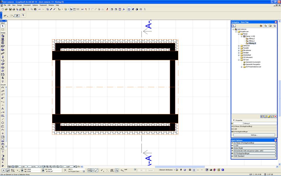

I have problems with walls "cut" with SEO where the roof acts as the operator elements. However in plan view the walls that are below the roof AND below the Floor Plan Cut Plane still shows. I am sure I am missing something very simple but I can't figure out what I am doing wrong.

Here is the section showing the level of the Floor Plan Cut Plane level...

Seo operations don't show on floor plan. You can trim your wall with you roof and this operation does show on floor plan. Sorry for my english
If you give your roof cover fill a non-transparent background (white pen 19 or 91 in standard pen sets) it will obscure the walls below.

Thanks - this solved the problem!
