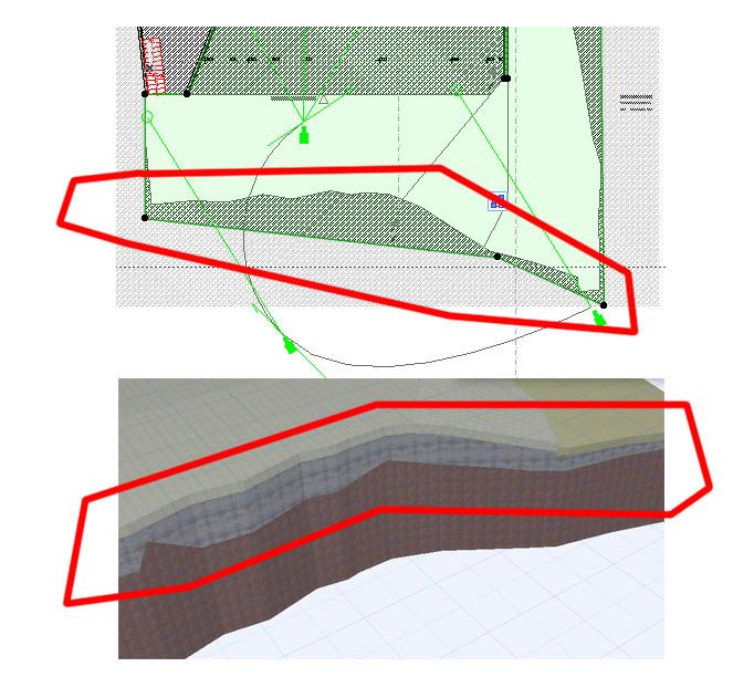

SEO doesnt adjust in plan view (shows in 3d)
I've trimmed few objects using SEO, and as seen in the image few of them got trimmed (white ones), but the hatched (terrain) object is shown completely.
- I did not convert the objects to morph since changes are still pending.
if I switch to 3d view,all SEOs are adequately shown (SEO trimmed as should).
could someone explain why certain objects are shown as should in top view, and some are not.
only difference from objects that are displayed properly, and the ones that are not is that the "proper" ones are "roof" objects, and the "wrong" ones are "slabs"

I don't quite follow your description of the problem. It looks like everything in the lower picture has been cut. ?

I think it is about floorplan.
SEO on mesh will not show up in floorplan.
Roof will show SEO.
You could convert the mesh to a morph (I would keep a copy of the mesh and SEO on a seperate layer with an unique intersection group number for future editing). It should show fine in floorplan and 3d and gives you the benefit of hiding or showing edges.
the "cut" is properly shown in 3D view, but in floor plan the whole object is shown (dashed hatch)
- the white elements in floor plans are "roof" objects (top layer in 3D)
- the dashed elements in floor plans are "slab" objects (bottom 2 layers 3D)
Roof will show SEO.
Thanks for confirming. I wasnt sure if I was doing something wrong, or if there's a way to make slabs behave as expected.
I dont see why Graphisoft decided to implement it that way?
ATTM considering using "roofs" for all my slabs... since they offer far more control then "slabs".

Roofs use a true projection. Slabs are symbolic.
Roofs do not participate in priority based connections (with building materials), though, where slabs do. There are a few more perks where finish layers meeting windows/doors will automatically extend with slabs.

what would you suggest to use as "ground" material in underground stories?
4 example, when drawing a basement, the ground around it?
in the picture above, I just used a "Zone" under my whole project with a hatch. But I'm thinking of finding a more model oriented aproach.
since slabs are schematic and wont show, I was considering using roof tool to create the terrain around it (and give it thickness 5m, and asign "soil" material to it.
Roofs do participate in priority based connections, just not automatically like Slabs do.
If you use Connect from the context menu between a Roof and other elements, then PBC will be used.
