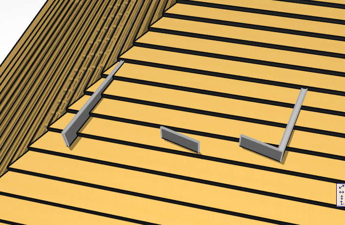

SEO urgent problem
How come SEO cannot trim out the wall???

Eduardo Rolon
  • select roof
    Right click and select connect SEO
    Click to deselect roof
    Select walls
    In SEO panel select Add to Operators
    In Operators select "subtraction with upward extrusion"
    Click execute
Eduardo Rolón AIA NCARB
AC28 US/INT -> AC08
Macbook Pro M1 Max 64GB ram, OS X 10.XX latest
another Moderator
Looks to me like your roof might actually be a complex profile wall or beam.
In that case you need to make its priority strength stronger than the walls otherwise the walls automatically cut a hole in the 'roof' (which you will see if you select it).
Because there is a hole there is nothing for the SEO to use to cut with.
Make the 'roof' stronger than the vertical walls so it passes through them and then the SEO will work.
