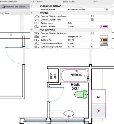

Traced elements here should be showing as sink is

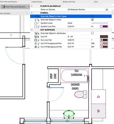

But only sinks are actually viewable
sink settings
toilet settings

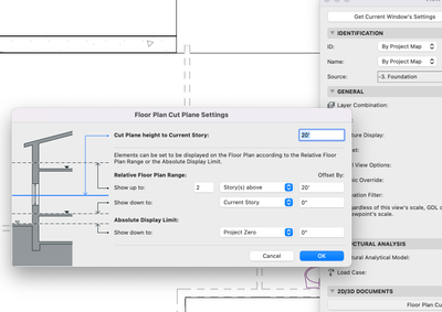

 Foundation cut plane settings

JKL:
These are the options I see for WC 26. Are you using a different library part?
