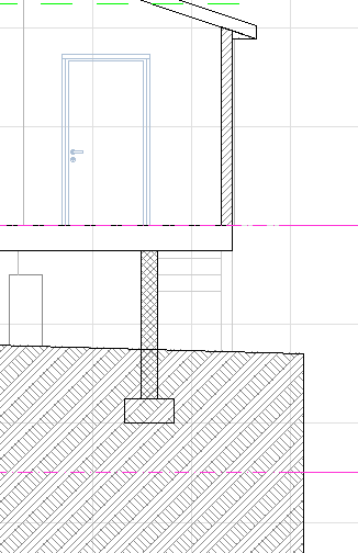

I modeled the site using the mesh tool, although it is not 100% accurate. When I cut the section the cut line of the mesh runs through the foundation wall. What is the best way to deal with this?
Maybe turn off the mesh and draw a cover fill? ... Defeats BIM.

Another reason why I do Not use the Composites with the Gyp-board below the floor joist slab.
Extra Line on Exterior elevation.
The problem is represented better with a Vertical instead of Horizontal Fill pattern.

I have changed over to representing the roof as a Sheathing/Roofing combination and Modeling a Fascia, but I have not "moved" to only representing the floor as sheathing. I have desired to.
JAY -
Can you show me how you do this, representing the roof as sheathing and modeling the fascia?
Seiss, see private message that I sent.
archislave
Can you show me too? Maybe all of us since this goes against what we have been taught but is actually closer to real construction!
