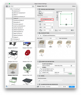

It is also useful for positioning, to set a reference level for the split levels in the Options/Project Preferences/Reference Levels. You can choose these levels to place the objects relative to them. Also, you can determine all positions uniformly compared to Sea Level or Project Zero.

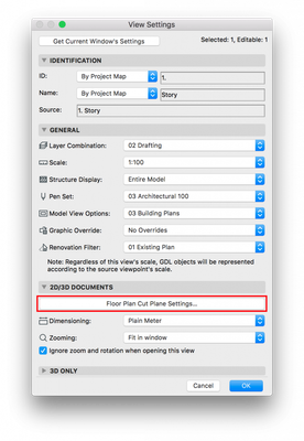

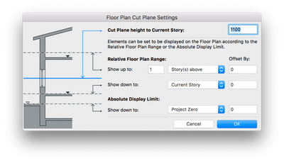

Save separate views of the story. Due to the split levels, a unified Floor Plan Cut Plane cannot be chosen for all the levels. Therefore, you have to focus on a part of the story and set the Floor Plan Cut Plane height for that part correctly and save with the view of these settings. Do this for all parts of the story.

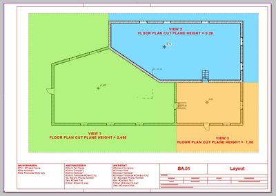

Connect these separate views on the layout along the line of the level change. Hide the drawing titles and add new points to the polygon of the drawing frame to follow the splitting line, if needed.

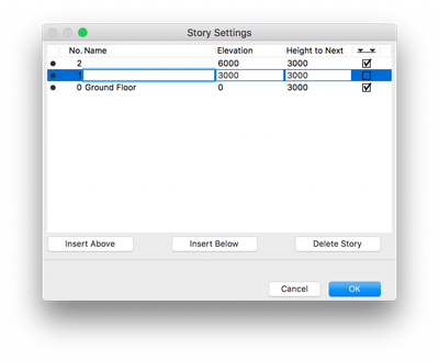

NOTE: However, it is not always helpful to settle everything on a single floor. If the height difference is bigger than the usual Floor Plan Cut Plane height it is suggested to divide the model into further stories but under this value, you could work within a single floor.
