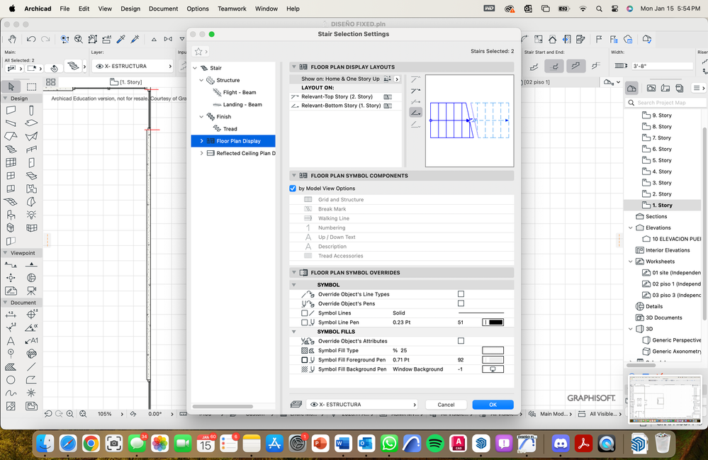

Hi!
I have some stairs going from story 1 to story 2, and in the settings I have them to be viewed on one story and one story up, but when I go to the second story plan, the stairs don't appear. Am I missing something?
Thanks!

Hi @adrianasofiasm,
I guess you drew the stair from up to down so its appearance is flipped,
If you drew from down to up it'll appear correctly.

Given when your stair is showing it is showing as hidden, I suspect that your linked stories are incorrect. Do you happen to have a negative Home Story offset?
