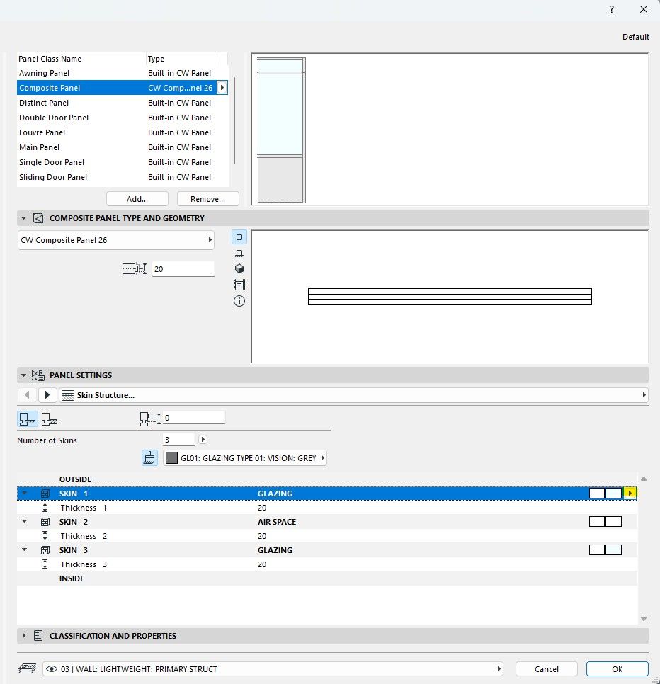

Hi Team,
We have come across an issue in AC26 when trying to use Composite Curtain Wall Panels. When adjusting the Skin Structure, we are unable to expand the Building Material dropdown to change the Building Material, effectively rendering the Composite Panel useless.
Is this a bug in AC26 that others are experiencing?
Drew.

Hi there, yes this is a known issue in Archicad 26. Better have a check with your local support for further information about this bug.

Hi, yes, it (DEF-10436) is planned to be fixed in the next update to Archicad 26, coming early next year.
