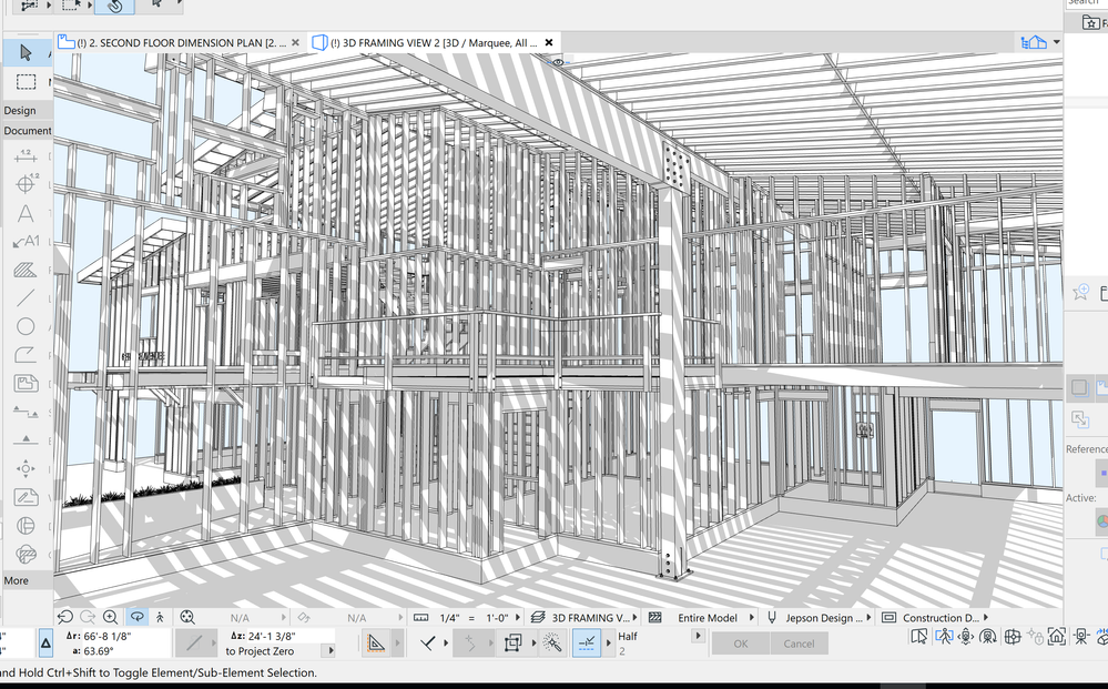

And how is that working for you all with Interactive Schedules?  I mention this because if you don't need to schedule the Framing per how many units of what length to order, why are you modeling the framing?  Just curious.
My accessory gives me all the data so it's pretty good on that end. I almost have cut plans coded too.
And really I do it for the sake of knowing my design functions and can indeed be built.
But that's easy when I can frame the house in minutes lol
My accessory also has sheetrock sheathing and baseboard all built in so it's extra detail with no extra work.
Hi Steve. I'm just primarily modeling it for visualization purposes to help the client, builder, and plans examiner understand the framing concepts. From a liability standpoint, I'm not sure I'd ever provide a detailed schedule even if I could.
