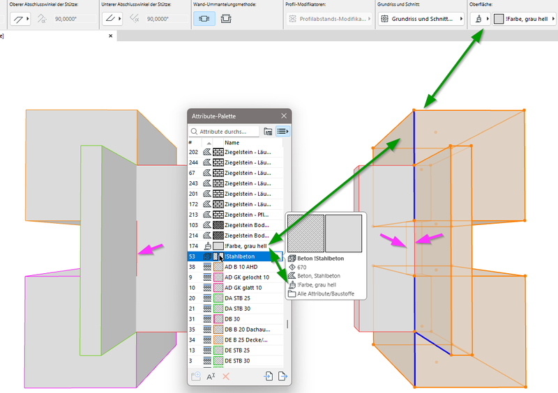

Can someone help me with this, the edge at the intersection between the walls and column is not showing. This happens at various parts of my model. I attached the plan and 3d view for referenece. TIA

I feel obliged to point out that - in this situation - Archicad doesn't work as it should.
The edge does not disappear because someone (Graphisoft or we users) wants it to disappear, but it happens nonetheless.
Barry's finding is interesting although I can't reproduce it...
@Barry Kelly  schrieb:
... simply overriding the column edge surface, with the same surface material, made the join show.
 I'd suspect that ACs "show/hide edge algorithm" is forced to check the edges in a different order.
My personal gym 🤓
AC27, left and right are mirrored, otherwise identical, selected elements on the right to show hidden edges.
Only one surface material, only one building material, no error possible (green arrows).
Red wall has a lower junction order than green wall.
> green is protruding and has no edge to show; red has an edge to show (pink arrows).
Top columns (orange outline) have their surface overwritten with the same and one and only existing surface material.
> top column right is last selected element and shown in info bar
Bottom columns (pink outline) have their surface by BM.
No edge for...
