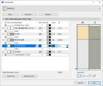

What should I do if the wall connection is abnormal?

In the construction process, in Korea, there is a process of applying mortar on the concrete interior surface and tile it, and in some cases, the concrete interior surface is ground and cleaned.
(a process of grinding and cleaning the concrete surface with a grinder to flatten it)
Then you have to specify something on the interior surface of the concrete...
I asked you because I was wondering if it's okay to do it with zero or if you're doing it in a different way.

Hello,
"I asked you because I was wondering if it's okay to do it with zero or if you're doing it in a different way."
Personally, if a material has a layer of zero thickness, then I do not represent it because it will be invisible at 1/50 and I can differentiate the final appearance of a wall by other means.

Sorry to keep asking.
Question 1. I'm curious to know how to deal with content that is specific to the building process and process it in the schedule.
A thickness of 0 is the process the workers work in, and it has nothing to do with the shape.
Since it is surface that count, I am curious to know how you do it.
