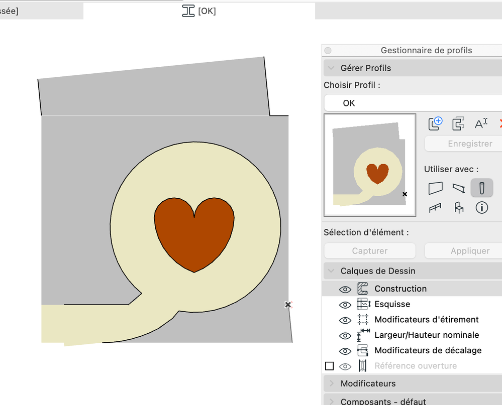

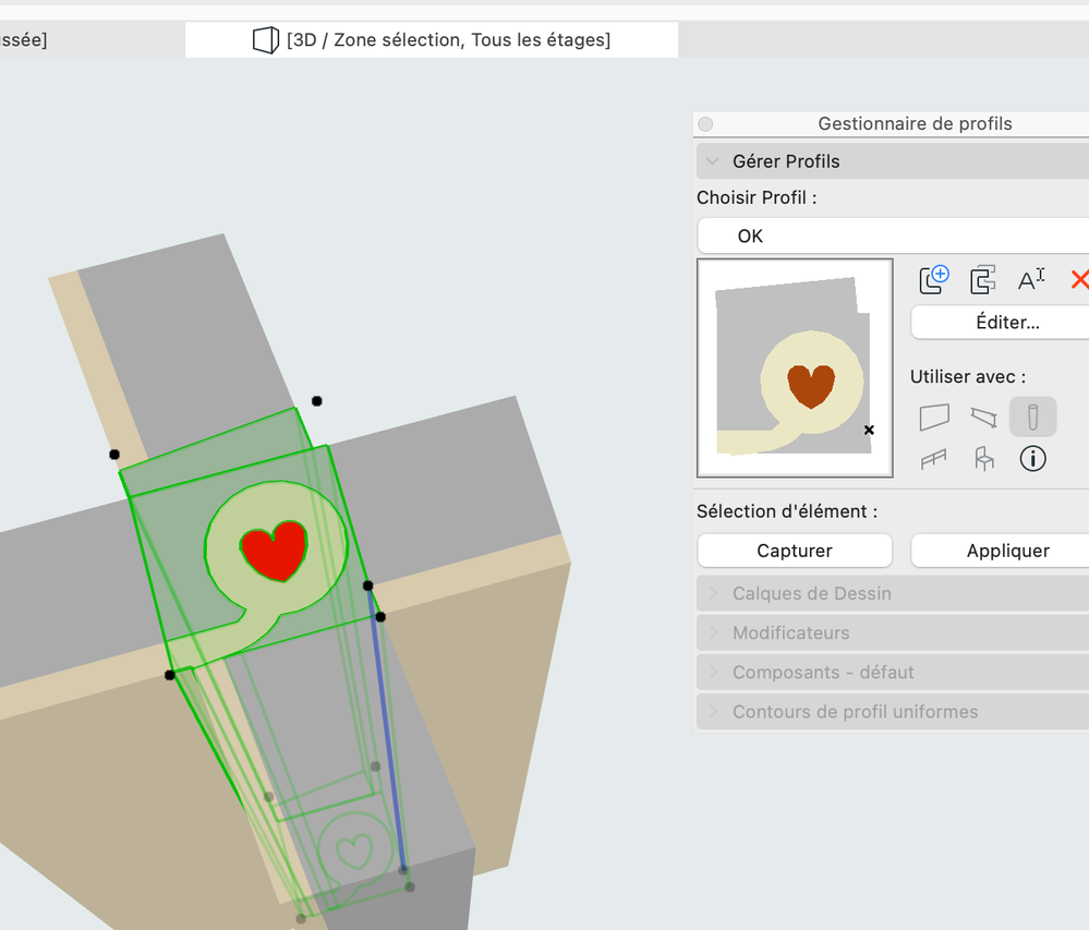

Hello LeeJaeYoun,
Here is some image of the principle of a custom post to join 4 walls.
undefinedundefinedundefined
Christophe - FRANCE
Archicad Designer and Teacher
Archicad 15 to 28 FRA FULL
OS 13 Ventura - MacBook Pro M2 max- 32Go RAM
"Quality is never an accident ; it's always the result of an intelligent effort" John Ruskin
12 REPLIES 12
Hello LeeJaeYoung,
Despite moving the reference lines of each wall (in pairs), I did not manage to create a perfect match and I came to a radical and effective solution. I make a personalized column profile on which the 4 walls are connected without crossing.

Solution
Hello LeeJaeYoun,

thank you ^^
What you're saying is that it's good to have a complex column at the joint point.
Is this the default way in Archicad?
With columns and walls ...solve all planes.

Hello,
"What you're saying is that it's good to have a complex column at the joint point."
You are right but what I am saying is to get a solution about your request 😉
Please note that it is nevertheless necessary to plan to modify the classification of the connection column. It is not a column but a wall which must therefore be exported as type ifcwall.
"Is this the default way in Archicad?"
I do not think so ! It is mine for sure.
