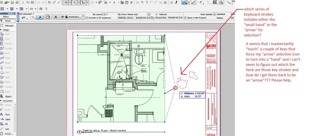

I'm stuck folks...it seems that from time to time...I'm touching or toggling a combination of key strokes that switches my selection icon from an "arrow" to a "hand pan" tool? I'm not sure what I'm pressing when I cause this to happen but it's annoying as heck...and I'm having trouble getting it back to standard "arrow" selection icon.
I know it's somewhere on the left side of the keyboard. somewhere when I inadvertantly hit the "tiddle key" or the "tab key" or the "ctrl+esp" or tildy combo...but I just can't seem to figure out WHICH of these key strokes and combo keystrokes I'm causing to switch the arrow selection icon to a hand icon...please anyone...help.

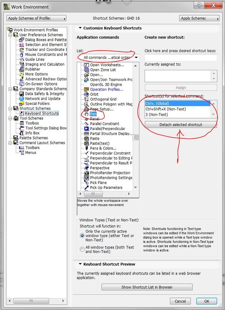

Hi.
Try checking under Work Environments - Keyboard Shortcuts.
Look at the entire list in alphabetical order.
Find 'Pan".
See what key combos are assigned to it.
Then change the keyboard shortcut so you don't hit it by accident...
My pan shortcuts are not easily hit by mistake.
-Cheers

i checked the working environment and I don't have any assigned shortcuts. it's very odd...happens when I'm holding down my left "shif" key while I'm toggling thru objects trying to locate what's on top, bottom etc...
sometimes I click my finger on a button, then all of a sudden the hand pan icon comes on. I can still select with the hand pan icon but it's not very accurate. it's as if as though the "arrow" selection icon changes to a "hand pan" selection icon because of this certain key stroke combination.
