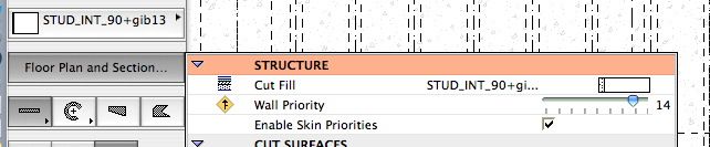

not sure i understand exactly how wall priorities work..what exactly would be the correct priorities for this intersection to be accurate?

that is indeed the ideal development direction for this type of thing: 'physical' material definitions that automatically take their attributes through to any required level of interaction within the model. until then, i remain a faithful masochist: working my skin definitions based on the hierarchy i outlined earlier . . . and leaving only number 16 available for the commercial-environment-friday-afternoon-issue-manual-over-ride times . . .
philip - i rarely use a plain ol' vanilla wall as a wall anymore. i define composite structures for walls containing even only one skin. there are benefits that include being able to choose walls based on descriptions grounded in reality, and being able to lock fill orientation to the wall orientation rather than to the project origin.
what's needed is a bit of rigour when setting them up and expanding them . . . and you need to always ensure that the priority over-ride toggle in the wall 'floor plan and section' settings are set to always 'enable skin priorities'.
HTH
