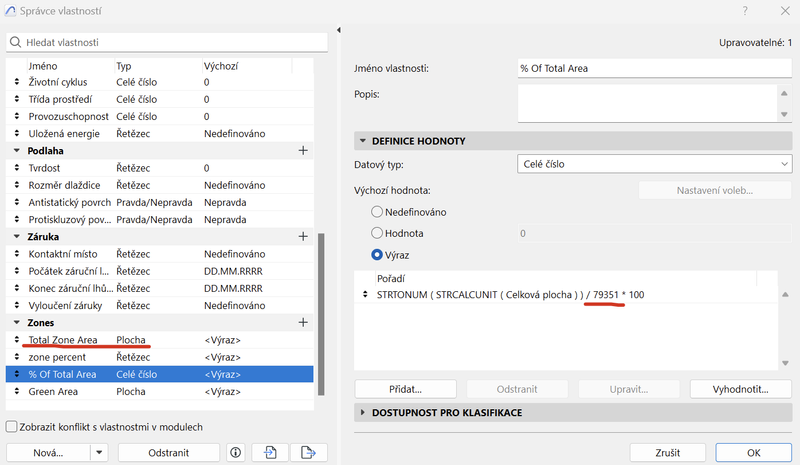

I would like to ask is it possible to get value from 1 exact zone into a property automatically? So there is no need to type it manually but let Archicad read it as a new property automically in the formula like Barry wrote before
What I get in the table with % of total Area is correct table:
But I need to find a way how to attach a number 79351 automatically with a property - is there a way?

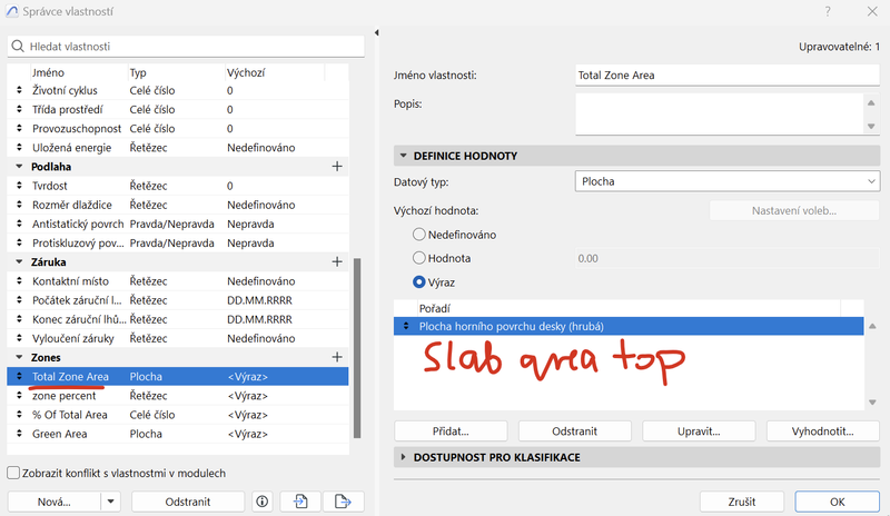

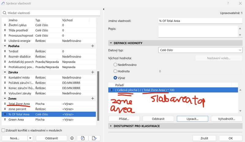

I have a thought to have just 1 slab in my project to use it as an area for the plot (I don't need slabs anywhere else in my project) but I have a problem with right calculations - should I convert the slab area number into something else to then be able to use it in the formula with zones? Not sure why the calculation doesn't work
Any idea how could it work? Thank you in advance.

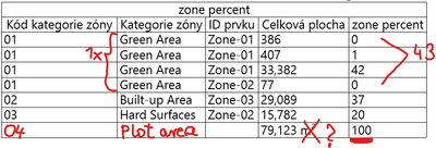

Hi Gerry, so finally after running your python script I got table with %:
Still, I run into some problems:
- How can I sum up all zones that have category number 01 (Green Area) so the total % shown will be 43.
- Also is it a way to not show m² in the sum-up cell?
Best option would be to have there a name Plot area and use it as a zone but of whole plot area but I would need to define it in the python script as a
totalArea = ...?
but not sure how to do it. How one can say what zone ID should the script use for totalArea value? I would give it an ID name PlotArea then can python recognize it? Thank you in advance for any tips and help.

I added a "Total Area" row to Project Info and the expression can recall this value after you turn the text to number (STRTONUM).  I know it's not as elegant, but updating the project info is not a big deal. Not to mention that there are always other places in a project where this total is used (project info on a site plan etc.), so I can refer to that total with an autotext.
(I did the same with "Unit Total" in order to calculate the % of 1 bedrooms, 2 bedrooms etc.)
