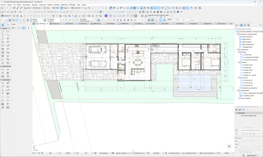

Don't need to teach me about workspaces. I have my own with my own palettes and shorcuts. Didn't implement it in the english beta version because don't want to drag old things into the new interface. But never realized that something so deeply buried into the work environment would be available as a command.
My workspace. There are some scattered buttons here and there....
