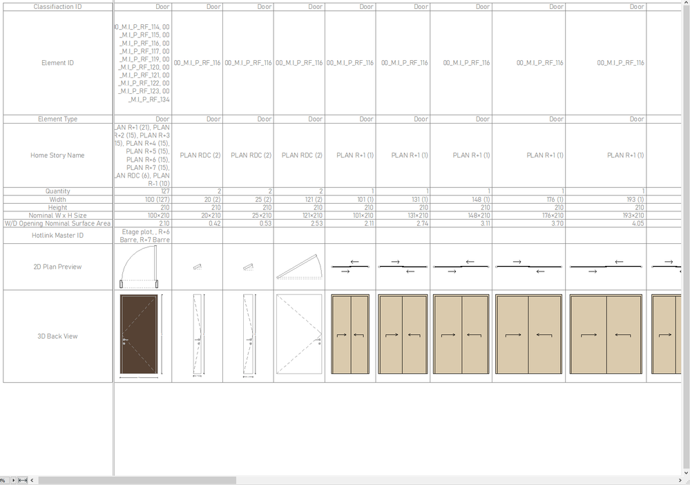

I'm making a joinery list for a project. With Archicad's automatic tool I can display the ‘3D Back view’ of my elements. I see that it is possible to dimension them manually one by one but I would like to know if it is possible to do this automatically (I have nearly 50 different elements to dimension).

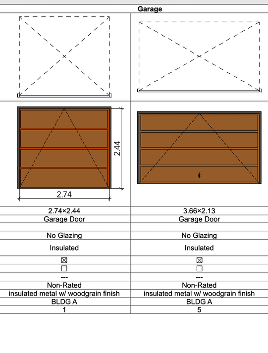

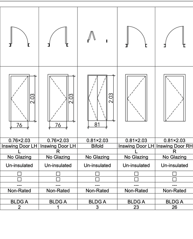

Select an image and turn on the 'Add Automatic Dimensions' option.
It only gives overall dimensions.
If you want more you still have to add them manually.
