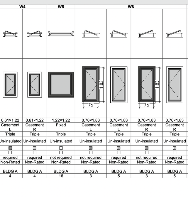

Hi Barry--
Is there a reason why some of the items in my schedule are not being automatically dimensioned? Please see screenshot. Seems totally arbitrary.
2025-01-06 10:21 AM
I have no idea sorry.
Try turning the dimensioning off and then on again.
Or maybe select the preview and open the 'annotation' and then OK.
2025-01-06 02:56 PM
I had the same issue and I did them manually...
2025-01-06 06:10 PM
I tried both those things...no effect. Will have to manually dimension. Thanks for your thoughts Barry.
