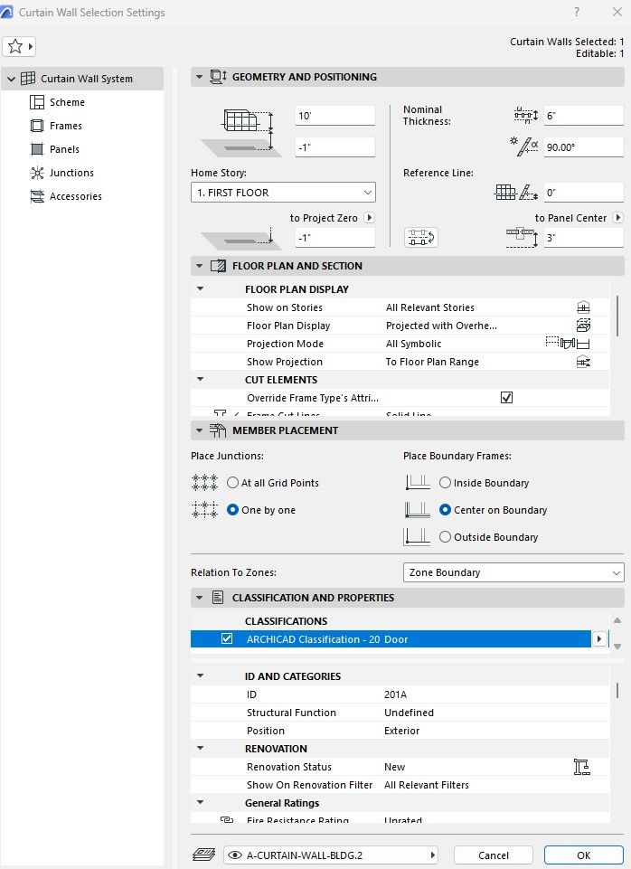

Doors that are part of the Curtain Wall System are not showing in the door schedule
Gisele
The panel of a curtain wall system has a CW Double Door type; (see attached screenshots). How to add this door type to the door schedule?

Solution
BrunoH
add a first line to your schedule criteria "Element type is panel OR"

Solution
Gisele
Thank you, Bruno.
