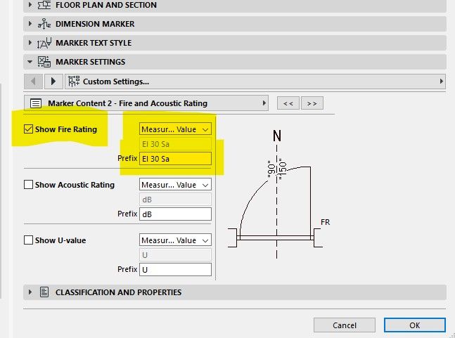

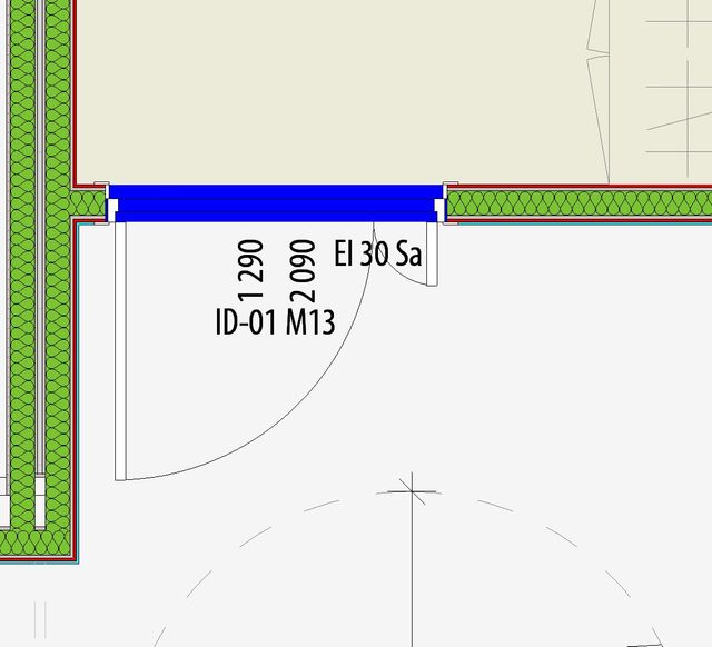

Hi, is it possible that fire rating on plan will be also automatically visible in schedule for doors? As you can see, I have inserted values in door marker, added fire rating option in schedules , but in door list Fire rating column still blank, same for acoustic rating too.
Every time I have to insert those value manually, what I'm doing wrong?

Library Parts (element types created using GDL, including Doors/Windows, Objects, etc.) have their own Parameters. That is what you see in the Door Settings Dialog. The "Show Fire Rating" checkbox refers to the Door's own "Fire Rating" Parameter, which you entered in the "Prefix" and/or "Custom Text" fields.
Additionally, the project file has Properties that can be defined in the Property Manager Dialog and assigned to elements based on their Classification. So, a Door element can have its own internal "Fire Rating" parameter, and it may also have a "Fire Rating" Property.
You specified a value for the "Fire Rating" Parameter in the Marker Settings panel of the Door Settings Dialog.
However, in the Scheme Setup Dialog, you added the "Fire Rating" Property to be included in the Schedule (for which you did not specify a value in the Classification & Properties panel of the Door Settings Dialog).
So, what you need to do is you need to include the Door's own "Fire Rating" Parameter to be listed in the Schedule.

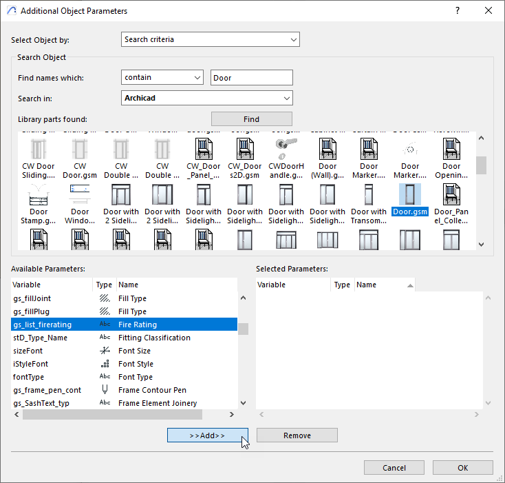

The following Help page tells you how to add a Library Part parameter to a schedule:
https://help.graphisoft.com/AC/28/INT/index.htm#t=_AC28_Help%2F140_UserInterfaceDialogBoxes%2F140_Us...
You will want to add the "Fire Rating" parameter of the "Door" Library Part or some other Door that has this Parameter:
