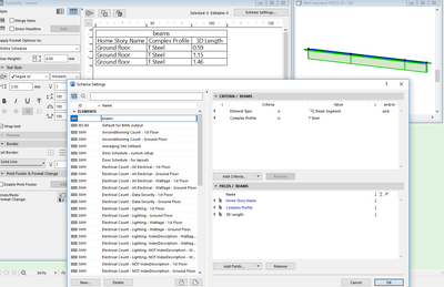

I have a weird problem scheduling beam lengths.
I wanted to schedule beam lengths and totals for specified Complex Profile(s).
When I create a chedule without Complex Profile filter criterio, everything works fine (see attachment wo criteria).
After I specify my Complex profile, each beam lists four times. Filtering out Beam Segment Element does not do anything here.
What am I missing?
Without Complex Profile FilterWithout Complex Profile Filter
With Complex Profile CriteriaWith Complex Profile Criteria

I dont want to group them. Each individual beam is displayed four times.
Grouping elements wont make total length correct either.

That wont work either. The listing displays ALL beams though I want to schedule only beams with specified complex profile.
Besides this criteria still quadruples my beam elements in schedule.

Nope, does not work. Still in quads. Besides that there is no length of beamonlysegment.png
Beam segments don't have a left and right length.
Only a 3D length.
Only entire beams have a left and right length available to list (I am not sure why).

There are four beams.
If I remove Complex Profile criterio they get correctly listed as single entry for each beam as shown in first post's image.
With Complex profile criterio there are suddenly 16 entries.
I just tried with 1 beam with 3 segments, all the same profile.
