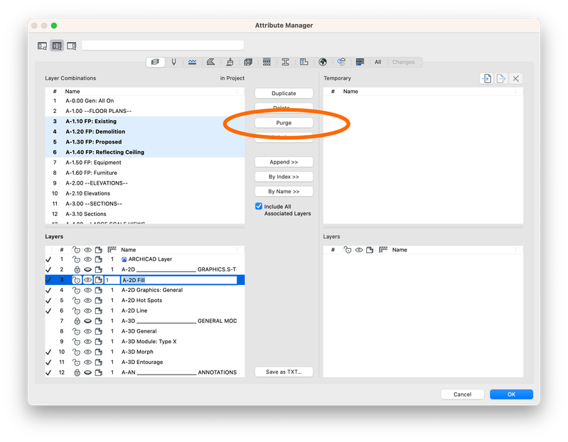

I would like to know if there is a purge option in Archicad to delete layers that are not been in use, (like in Autocad).

Go to Options>Element Attributes>Attribute Manager
Under the Layers tab you can see what layers you've used in the project and which are empty. There is a button at the bottom that will let you purge your unused layers.

the purge option does not seem to exist anymore in Archicad 25 unless  its another one of their useless icons that are meaningless to their function
Solution
Eduardo Rolon
Still in the same place as the last 10+ versions and for a change very nicely labeled.

interesting I'm using the Archicad 26 version 4022 USA FULL  it is completely different and now just called attributes. see my attached attribute manager first pdf, it is now concealed under a mouse click see second pdf. I had to go to another source to find out where they hid it. Archicad must be getting paid to make it harder to use

The new Attribute Palette is different to the old Attribute Manager.
You can still have both if you add them in your work environment.
With the new palette, you have to select your attributes and right click as you have discovered.

It is there under options on the basic 26 WE so you don't need to switch, just open it instead of the one called Attributes.
