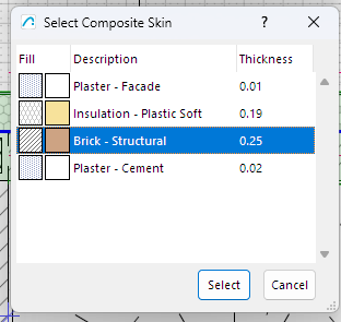

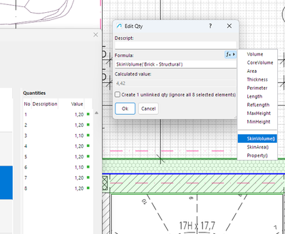

There was a question asked if BIMquantsLITE addon supports composite elements and by-skin quantities. It does - you can extract skin's area and volume for each individual skin.
When you click on a composite element, go to add qty, click on formula button, there will be a popup with quantities that can be extracted from an element.
Select SkinVolume() and a new dialog will appear, which will enable you to pick individual
skin.
Select a skin and click "Select" button. Formula will appear in the Edit Qty dialog.
