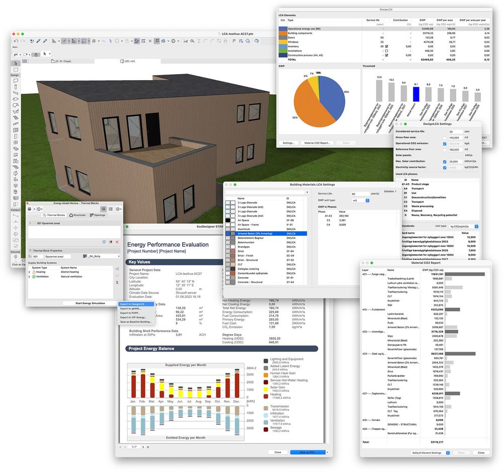

Graphisoft Center Danmark just released a public beta version of DesignLCA, a plugin to AC 26 that facilitates Eco designer star, in order to calculate a projects CO2 footprint throughout a given period of time (CO2eq/m2/anno)
DesignLCA calculates the "Global Warming Potential" as an "Early stage LCA"
With this method designers can (fairly) easy get a reading of your projects CO2 footprint where both construction and operation is taken into consideration.
There´s a Danish version, prepared to meet the danish regulations that will be implemented in 2023.
There´s an international version where vaules and settings needs to be adjusted to meet your local regulations, demands and EPD´s .

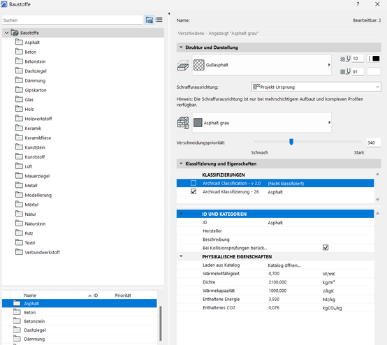

I have just installed the plugin with German template of Archicad and it works but I am missing DesignLCA materials, which are connected with Ökobaut, as you have here:
Is it possible to get these materials (even if it is in Danish language) or is there a way, we add our materials and connect them with Ökobaut? Since we don´t have any DesignLCA materials, we also do not have Environmental properties:

The Building Materials marked as DK/LCA is not based on ÖKOBAUDAT, but on a list of generic materials included with the Danish National Building Codes.
Please note that the Environmental Properties in the Archicad Building Materials are not used by DesignLCA. DesignLCA use the COe values in the Material LCA Settings of DesignLCA ...

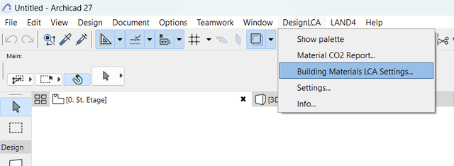

The LCA / Co2 values for Building Materials has to be added through the DesignLCA Building Material Settings:
Here you can set the unit as pr. EPD from which you get your CO2 values:
This is where the DesignLCA add-on reads the Co2 values, and NOT from the AC B. Materials Properties.
