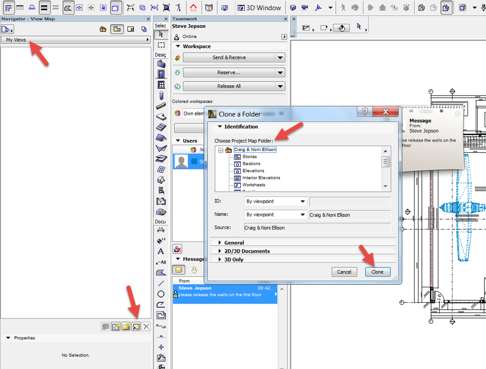

Hi all,
is there anyway to copy a view from the public views's list in the personal views one?

alemanda
Yes,
when you work in Teamwork mode you have public views (views that everybody can reserve and work on) and personal views (views that can be used only by you).
When you have hundreds of public views in the navigator it's a nightmare to jump from a view to another because you waste a lot of time searching in the navigator ...
so it is preferable to shortlist some views and make them as personal ones.
And I was just wondering how to copy a public views to the list of personal ones.

alemanda
Exactly
My question is "how to move/copy public views from publicviewsfolder to myviewsfolder?"

Steve Jepson
I am glad I was able to help clarify the question. Someone who knows will answer soon I hope. In the mean time I will see if I can figure it out. Also, if you figure it out be sure to post how you do it. Other TeamWork users will want to know as well.
Clone the Public Views folder ?
Switch form Public Views to My Views which is probably empty. Then click on the Clone folders tab and it will open a menu where you can choose the views you want. Something like that I think will work.
