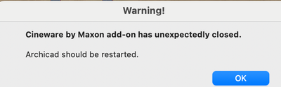

I just downloaded and installed ArchiCAD 28 and I get the same message regarding Cineware rendering engine quitting that I got with the 28 Technology preview:
Operating system used: Mac Intel-based
Solved! Go to Solution.

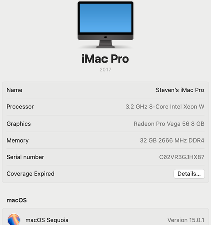

Yes, it worked fine in 27. I have attached a screenshot for system requirements and my system specs.
2024-10-15 02:30 AM
I have this problem too. I get the same error message after recently updating to macOS Sequoia 15.0.1 and AC28.
As a test, I tried a saved version of the same pln file in AC27 on Sequoia and got the same error message. It was previously working in AC27 on macOS Sonoma just a couple of days ago, same hardware.
Older suggestions / solutions to this problem have not worked or mention deleting files that don't seem to exist in the current version.
I have checked system security settings and both AC28 and Cineware have the necessary permissions as far as I can tell.
Any suggestions would be appreciated.
2024-10-15 03:36 AM
So it seems to be a Sequoia issue then.
Something in the Cinerender side of things has not been updated to work with Sequoia.
Be sure to contact your local Archicad support and report the issue.
