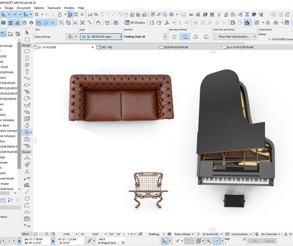

Steve Jepson
check out https://www.pixelsquid.com/ which is mostly for use with Photoshop.
Just a simple screen shot of these can be used in ArchiCAD.
Steve Jepson
quick and easy at - with a white floor that is.
