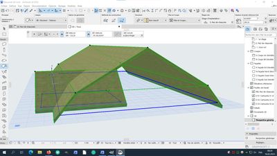

BrunoH
There's a simple way to do this. No need to convert to single roof plane.
Just create your complex roofs intersecting and select them.
Rigth click and choose "Connect to Roofs/Shelves"
 Click "Connect", that's all.
The result
The simpler way is always the best.

BrunoH
The result

The OP's dormers are a little higher than yours.
Also you may have trouble where the the roofs overlap and the main roof tucks under the dormer roof up to the dormer wall.
You can play around with the roof trimming body set to 'Pivot Lines', but then the pivot lines have to match the outside of the wall, which may not be wanted.
Set it up as multi-plane roofs and do the initial trim, but I still think it is easier to manipulate exactly as you want with single roof planes.
