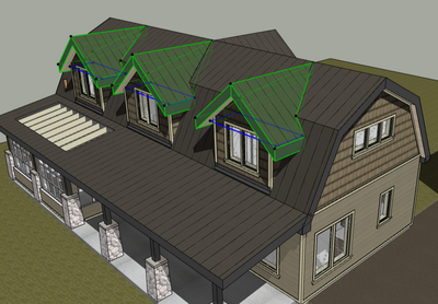

Is there a way to join dormer roofs with a main roof?  Right now I just cut holes in the main roof in plan view, and the manipulate the shape of the dormer roofs in plan but it never looks correct on the inside

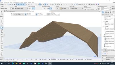

There's a simple way to do this. No need to convert to single roof plane.
Just create your complex roofs intersecting and select them.

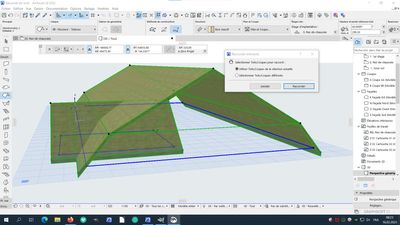

Rigth click and choose "Connect to Roofs/Shelves"

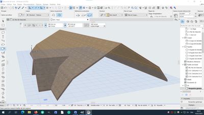

 Click "Connect", that's all.
The result
The simpler way is always the best.

Does the usual selecting one roof and ctrl/cmd-clicking the edge of the other roof not work?  The mansard roof  looks like it would make this really challenging.
If nobody jumps in with exact instructions, perhaps you could select all of the roofs (main/mansard and the dormers) and save them as a module MOD and attach it to a post here so that nobody has to start from scratch to make sure that their advice works in your situation?

The cmd+click to opposing roof method Karl mentioned should sort this. Dormer windows made from walls and roofs is witchcraft but it can be made to work. I find selecting all the roofs and showing only those in 3D using F4 or show selection in 3D is really helpful when connecting roofs. Also dragging them apart from each other at the junctions also makes things a bit easier. I’d be more than happy to show you how over a Teams call or something.
The result

The OP's dormers are a little higher than yours.
Also you may have trouble where the the roofs overlap and the main roof tucks under the dormer roof up to the dormer wall.
You can play around with the roof trimming body set to 'Pivot Lines', but then the pivot lines have to match the outside of the wall, which may not be wanted.
Set it up as multi-plane roofs and do the initial trim, but I still think it is easier to manipulate exactly as you want with single roof planes.
