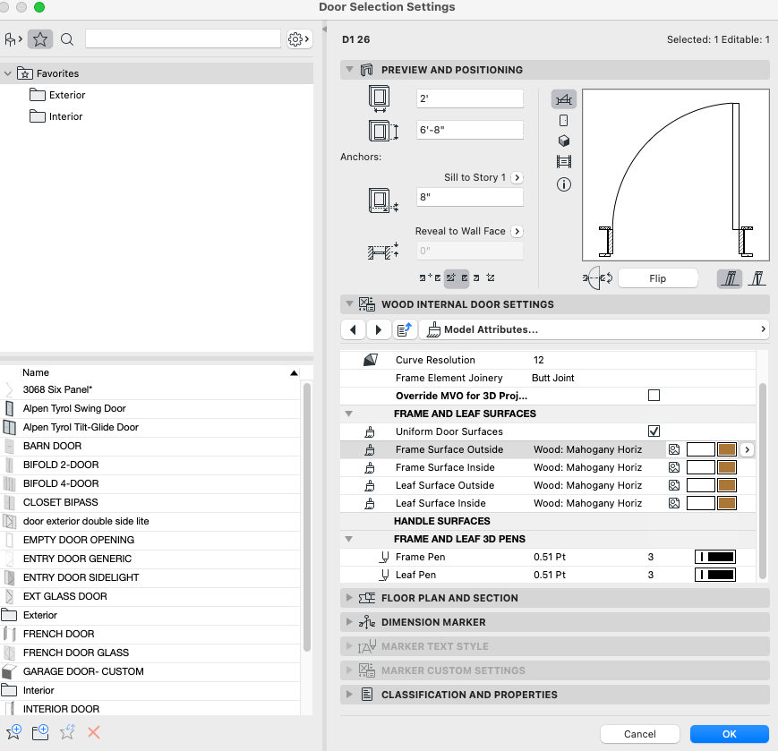

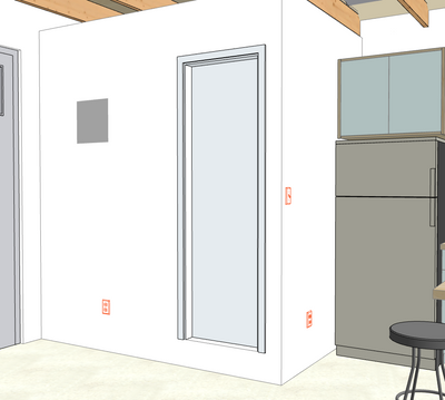

I am trying to add a mahogany wood surface to a door, but the door stays white.  As far as I can tell it has nothing to do with Renovation filters or Graphic Overrides, or model view options.  This should be super simple--  what am I doing wrong? 

Dave:
I think you are missing the Model panel in your Door Settings dialog box, which overrides the door surfaces. You have two options, both involve making changes in the Work Environment.
1. Turn on the Model Panel for the Door's Settings dialog box: Work Environment > Tool Schemes > Tool Settings Dialog Boxes > Door Tool > make Model visible. You will then have the Model Panel available to uncheck the Override Surfaces option.
1. Add the Surface Panel to the Info Box for the Door's Settings: Work Environment > Tool Schemes > Info Box > Door Tool > make Surface panel visible (or if it is visible, move it up the list). You will then have the Surface Panel available in the Info Box to uncheck the Override Surfaces option.

I just tried the "surface painter" tool and that actually does change the surface, although it does not change the surfaces listed in the settings.  Seems buggy.

Yes.  that was it. Thank you.
