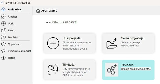

I have the need to download a file from the BIMcloud several times a day. We don't use team projects much in our work, but one person produces several smaller project files as standard material.
For this reason, I would like to have a dedicated icon on the home screen to open or download from the BIMcloud without team project limitations.
