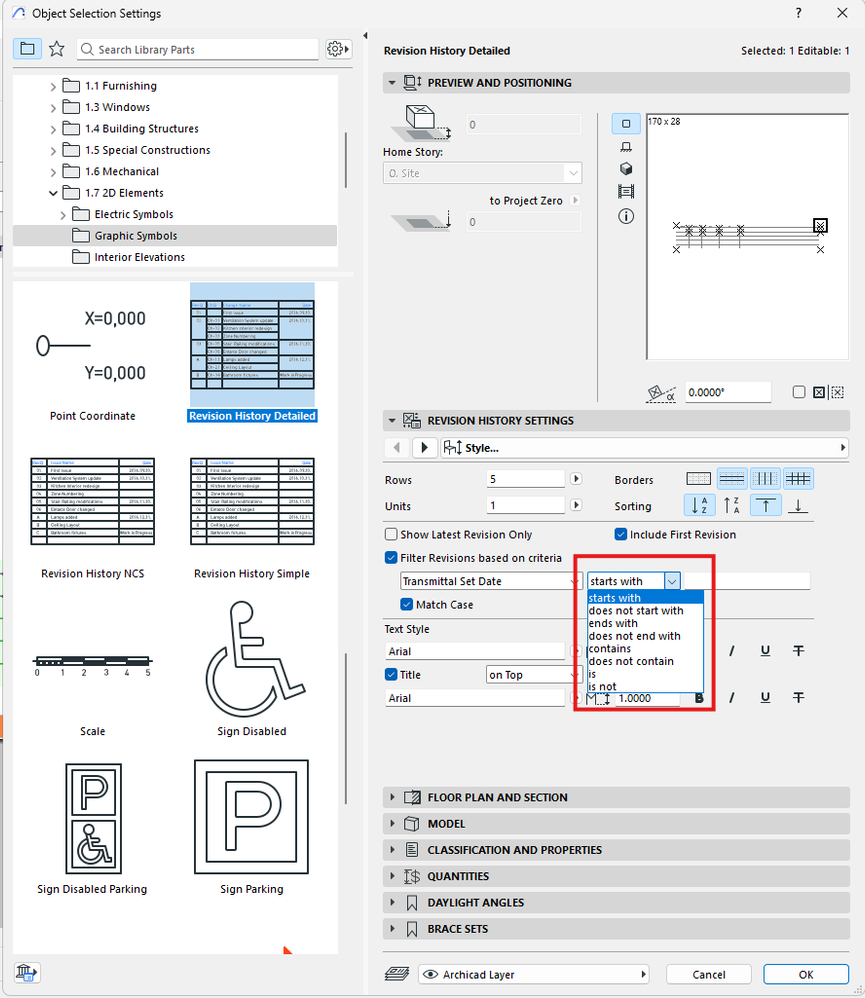

The "Revision History Detailed" object includes a toggle for "Filter Revisions based on Criteria", with one of the available criteria being "Transmittal Set date".
However, the options provided under this setting are quite limited:
Is
Is Not
Is Empty
Is Not Empty
Given that "Transmittal Set date" is a date field, these options aren't particularly useful for practical filtering. More appropriate filters could include:
Before
After
Between
Alternatively, rather than filtering by a static date, it might be far more effective to have an option similar to the Transmittal Set interface—such as:
Show revisions since Transmittal Set X
This would better align with typical revision workflows, where users need to display changes since a particular transmittal rather than manually specifying or comparing static dates.
