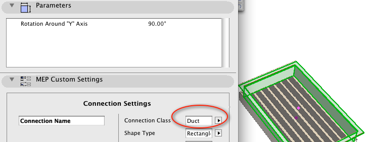

Where I have miserably failed is in understanding how to create Custom MEP Parts. The manual guide you to "select a file name and location for the parts" and two paragraphs later it says that the "the new MEP object is in the Library Managers Other Objects Group".
Maybe Karl or Erica could pitch in and explain better than the manual because I am lost on this one. I was unableto find where is that "Duct Terminal Settings" panel shown in page 53 of the Manual.
Maybe Karl or Erica could pitch in and explain better than the manual because I am lost on this one. I was unableto find where is that "Duct Terminal Settings" panel shown in page 52 of the Manual.
Hi Conrado,
The options for the 'subtype' are determined by the objects settings for the connection object. In the attached screenshot, I selected 'Duct' as the connection class ... when I save the entire assembly after having made this setting, the 'duct flow terminal' option is available in the subtype field of the save dialog... and the result is selectable with the Duct Terminal tool.
(I am a bit frustrated with the lack of hotspots for the MEP Connection 12 building-block object - just a center hotspot on either end. Makes it much more difficult to align it with things than if it had hotspots on each corner in 2D and 3D - including inner/outer edge of flanges, etc. I don't see an option for 'show additional hotspots', etc.)
