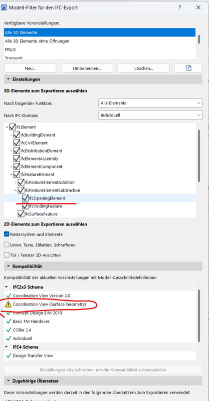

Hi!
I did notice the OPENINGS cause an issue! Size is not an issue at all!
There is an exklamation mark, if I export the openings:
I don´t know why thought. Any suggestion on how could I analyse the issue?
I deleted all the openings from the file and the error remains.
If i turn off openings in IFC translation settings, there is no explamation mark and my IFC file can be used in another software (no matter the size).
I do see this exklamation mark with different Archicad projects, also in the empty fresh one from Archicad template.
